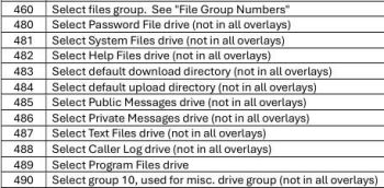

Another important point during 7.37 conversions is to make sure all file calls are going to the correct locations. Games that use REL files, SEQ files, or other support files often expect them to be in the original Systems file area. If you place them elsewhere, the program must be updated accordingly.
Examples of these kinds of data calls are shown below:
and
For example, if your games are stored in AUX 3, but the old 7.37 game expects the Systems drive, then in the core code only you might change:
  • all instances of GOSUB202 to GOSUB203
  • all instances of GOSUB481 to H=14:GOSUB460
This redirects access to AUX3.
Be careful to make these changes only in the module’s core code. Do not alter the standard overlay support lines unless you fully understand the consequences.
