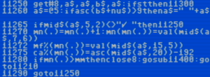

Conclusion: [ and @ are used for looping, with [ marking the loop anchor and @ providing the condition that causes execution to return to that anchor.
Also note, in line 8220, how the RETURN statement moved from line 8230 into the 8220 loop in version 8.1 (Example 2), indicating that it will execute the return if A$<>"" and A$ is not the HOME key.
[ starts the loop (the anchor)
@ is the loop condition and jumps back to the last anchor
@[x] jumps back if x is non-zero
] is the Color 64 BASIC conditional-action delimiter; it separates an IF test from the statement list executed when the test is true
This is used heavily with status values:
  • @[SR] means: if SR<>0, jump back to the last [ anchor.
  • If SR=0, execution falls through and the loop ends naturally.
So you will see patterns such as:
  1. perform read / set SR=ST
  2. use @[SR] to continue while status says “keep going”

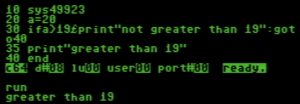

Topic Notes
if...£ √bbs.msgs
Example 8.0 8.1
1
Observation: The 8.1 authors often reversed the comparison order in variable checks while preserving the same end result.
Conclusion: This appears to serve as a not function.
Example meaning:
“LV is not less than CM%(2,2), and LV is not less than CM%(29,2), and FR does not equal 1, then print (P)rivate.”
Another example:

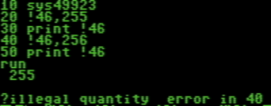

!46 Scratch Register
!46 was originally documented in 8.0 as unused. However, the 8.1 version uses it in disk operations across all overlays at the disk routine lines 710-740 as well as the log routine lines 8003-8040.
In those routines, !46 holds a temporary value. The lines around 710 use it to preserve a disk channel number, while the lines around 8000 use it as temporary variable storage.
It can hold values in the range 0-255. Any other value results in an “illegal quantity” error.
